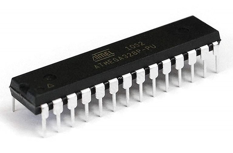

Major differences between ATmega328 and ATmega328P
1. The "P" in ATmega328P stands for "PicoPower," which indicates that this version of the ATmega328 microcontroller is designed for lower power consumption.
2. The BOD(Brown-out Detection) or low voltage detection in the ATmega328P can help ensure stable operation in varying power conditions by preventing the microcontroller from running when the voltage is too low.
There's one more variant- ATmega328-PU. It is not a "PicoPower" version. PU simply indicates the package of the IC which is PDIP.
For low-power version in the PDIP package, ATmega328P-PU is available.
